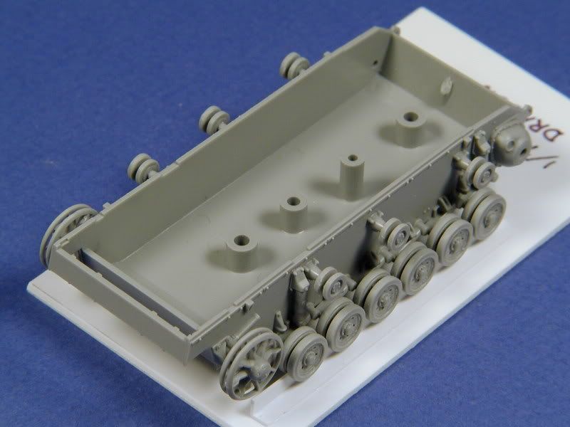

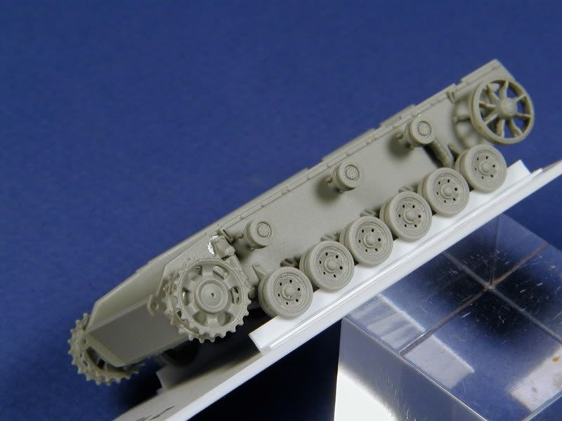

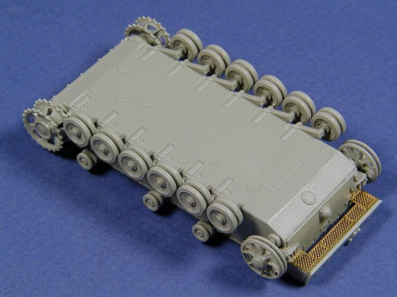

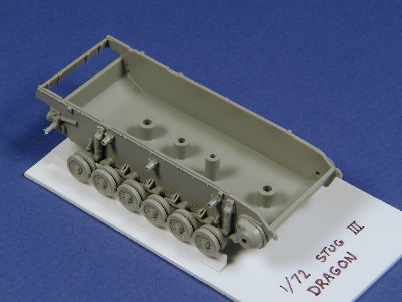

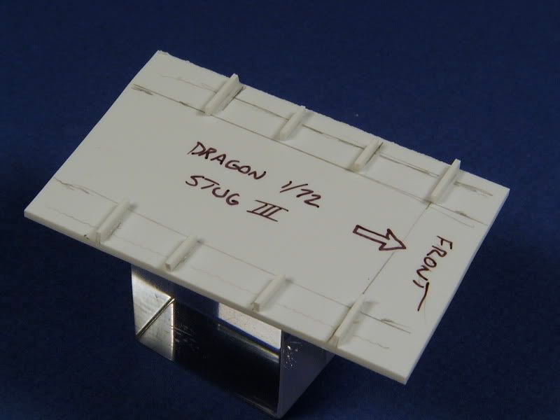

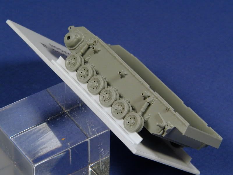

I made a jig to help keep all the wheels pointed in the same direction,

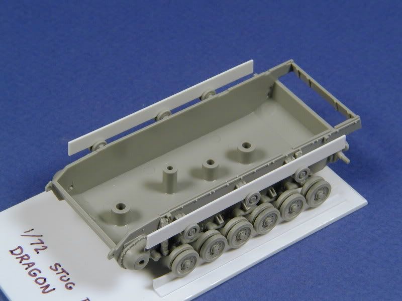

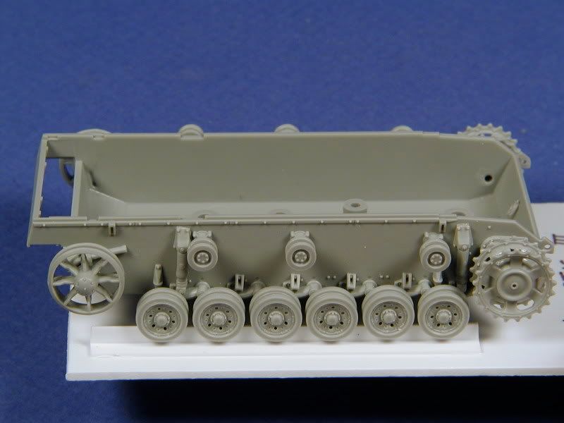

I used strip to keep the return rollers in line as well,
All the rest of the running gear,

Veeery nice little one. It´s the first time I see the Dragon stug so close and looks terrific and very clever building tips also John.

The piece is seen that it is excellent in quality, and I like the base for guide of the wheels, "EXCELLENT" good to make another tips... I am working in the tips of the bands, you don't create that I forget...

The little dragon Stug is really very detailed. I am amazed by how nice it is. But the running gear fit is a little sloppy. So I built the jigs you see here. I plan on building a few more of these so I will add it to my "tools".

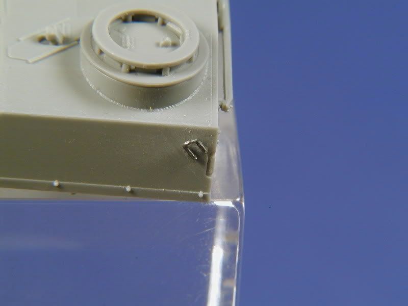

But yes this one will be mostly out of the box, I did fix the lift hooks on the sides of the air boxes. They are molded upside down. And I think I am going to flip the ends of the fenders up, as would be seen in winter. But I am not going to do too much, this is supposed to be a "quickie"

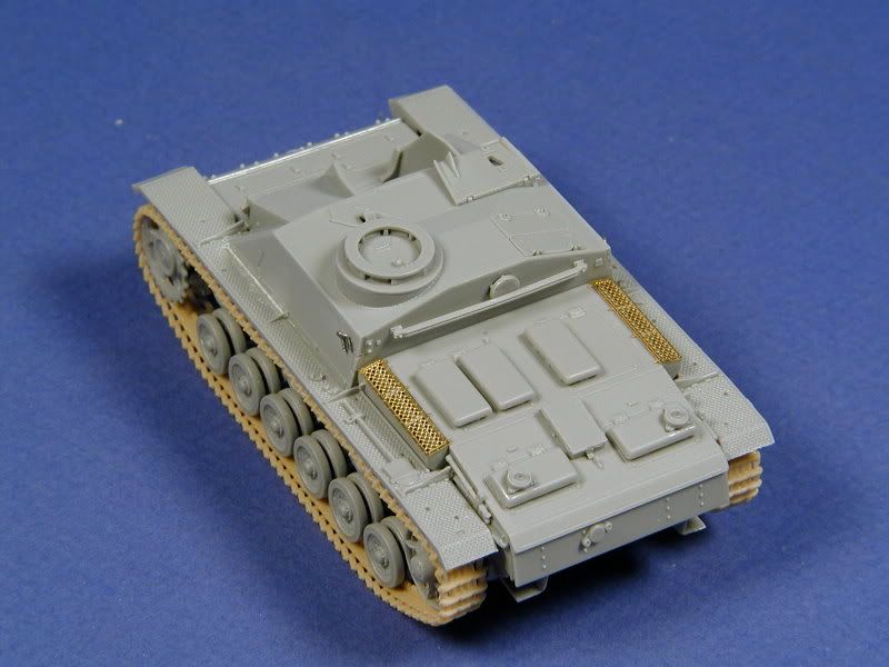

Hola,
More work done on the stug. It is enjoyable to work on, but the parts fit is a little sloppy, so care must be taken.

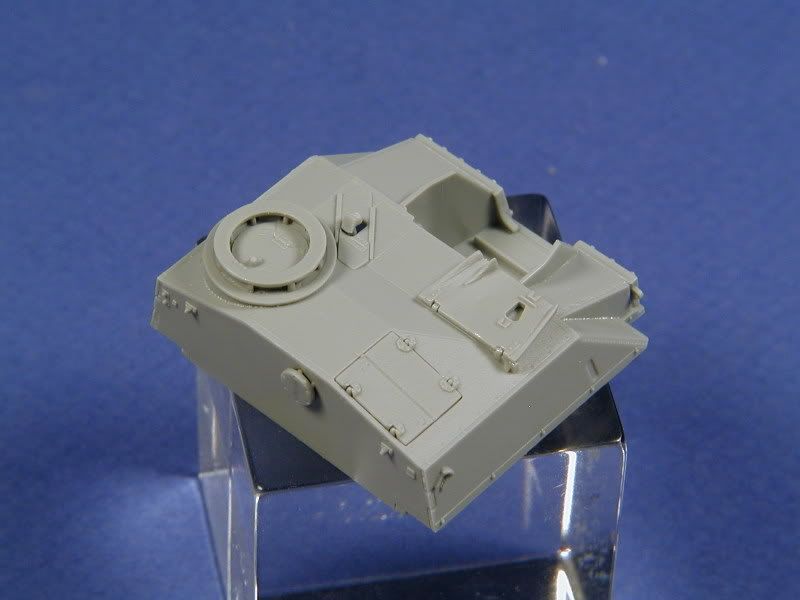

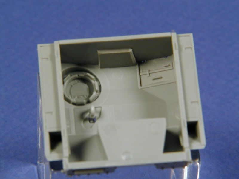

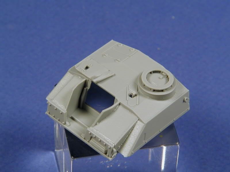

The crew compartment,
This is nicely detailed, there is even some interior detail, mostly on the hatches, but the Cupola has detail inside as well as the drivers vision block. the big flat grey thing is there to block off the ventilator that fell into the carpet, never too be seen again!

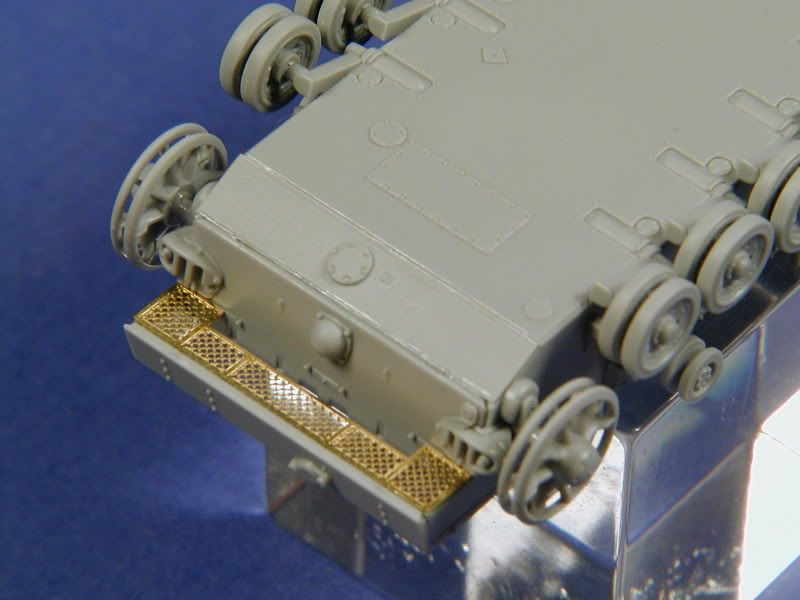

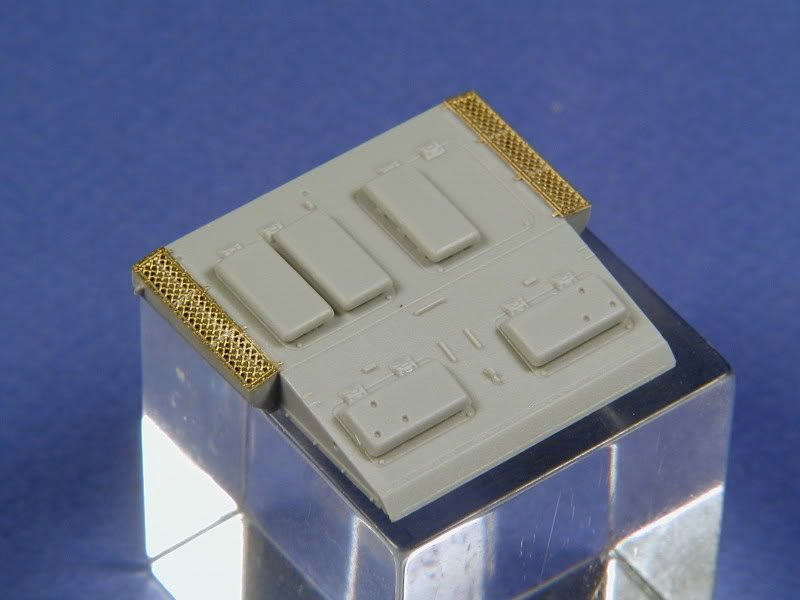

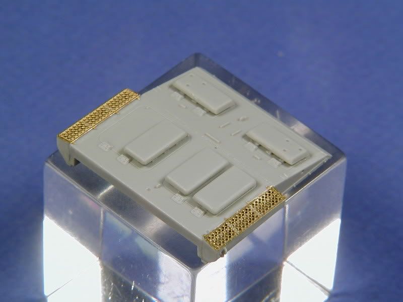

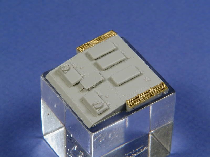

Photo etch parts are included. They are very nicely done, and add to the look of the model.

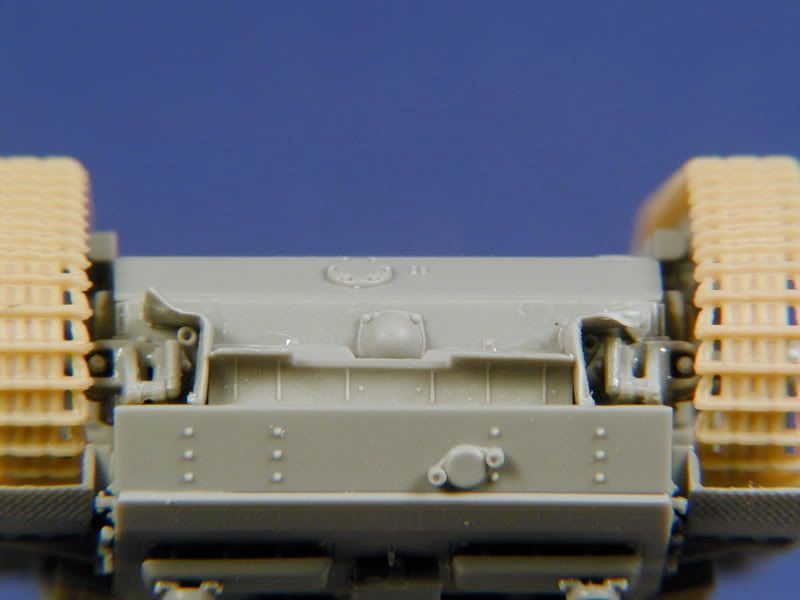

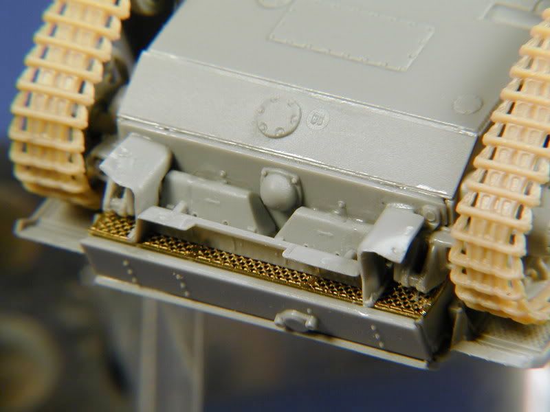

The underside is well detailed, and looks very complete. I have stayed away from reference books on this one. They make me want to start scratch building Smile

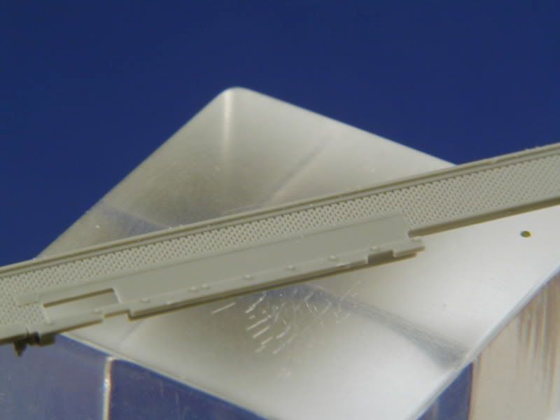

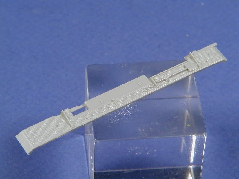

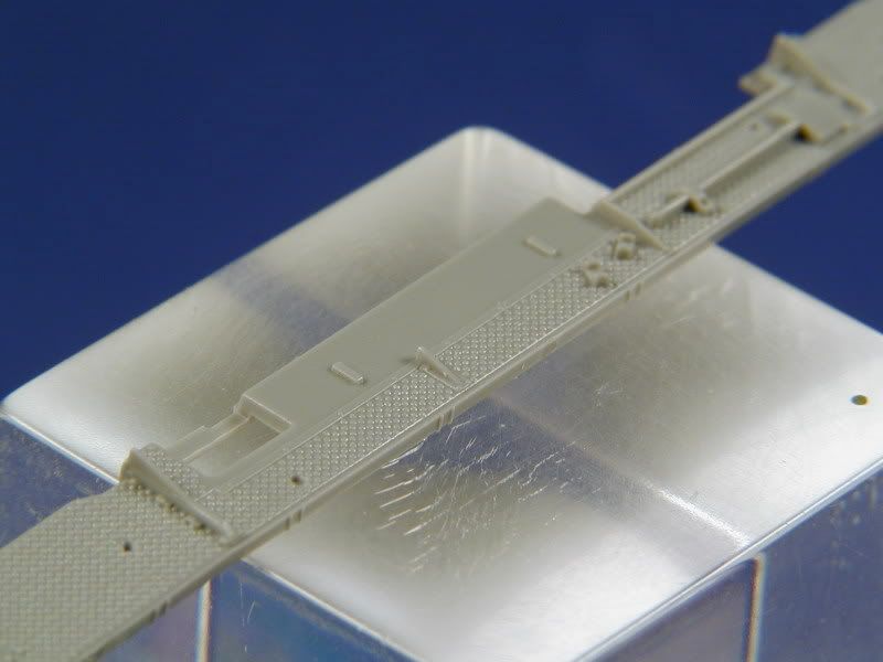

Even the undersides of the fenders have detail!
Molded on tools affraid OK, they are not that bad

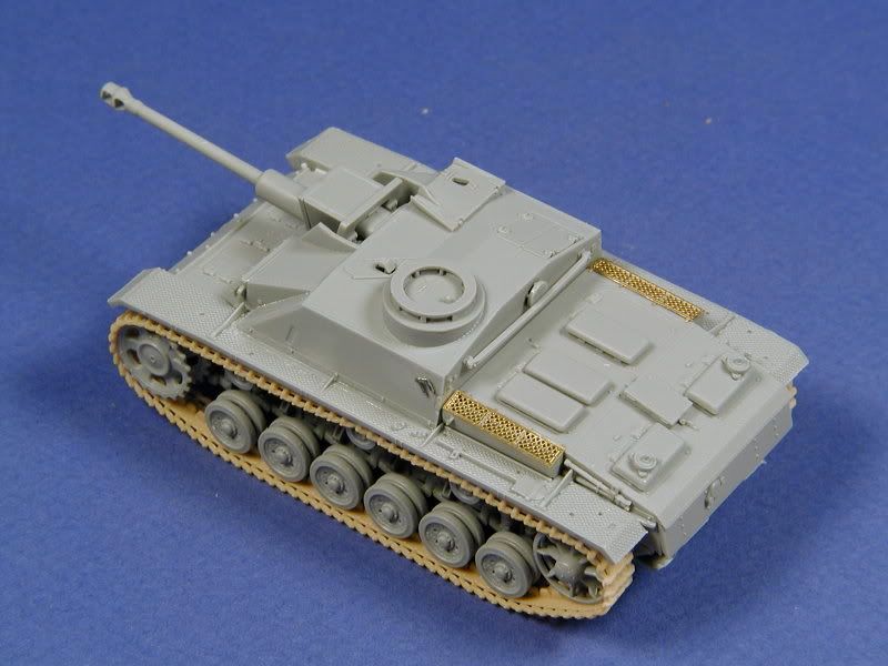

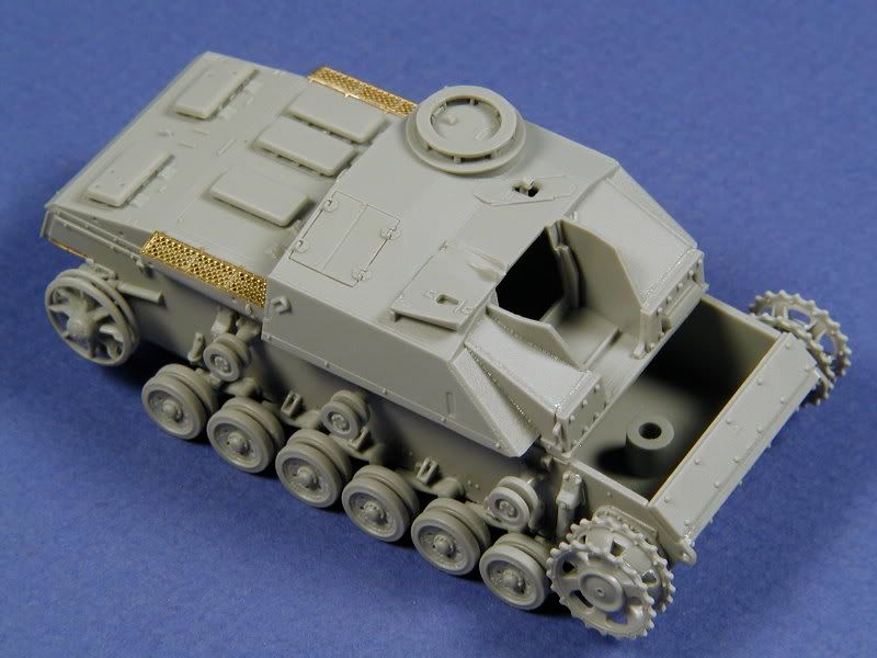

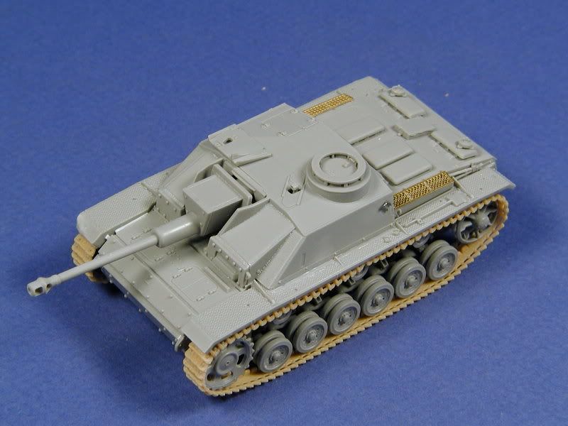

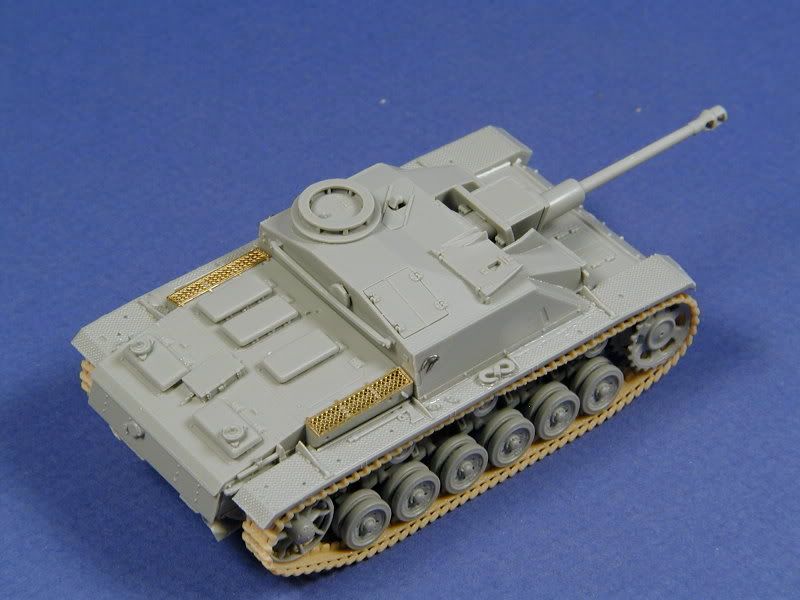

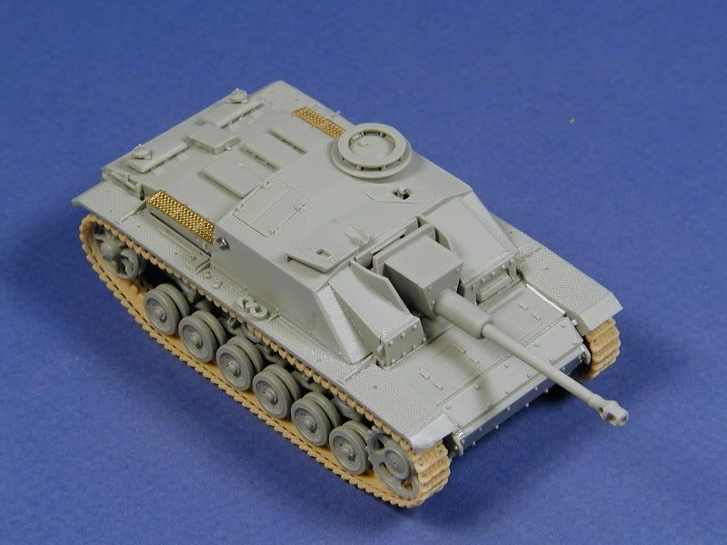

All the upper hull set in place.
There is still a lot to do. I need to fix the molded on loops on the hull side......

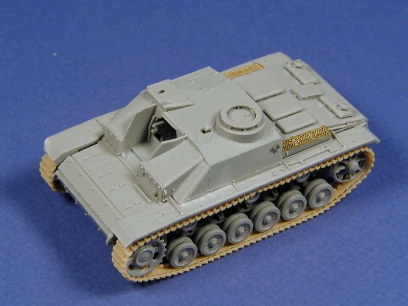

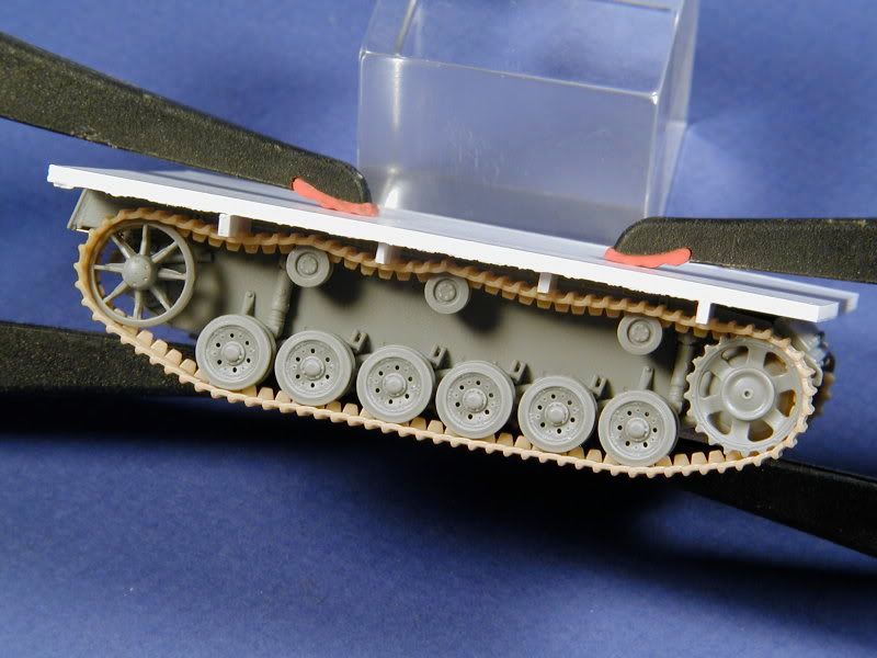

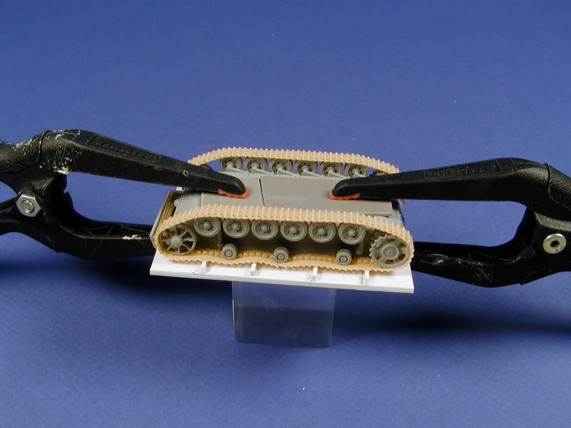

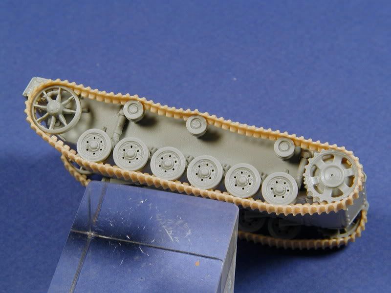

Time for Tracks! The kit tracks are not bad for rubber. And who would want to build them up link by link at this scale! affraid
the DS material glues very well and they end up being strong and flexible, which helps for this next step. Getting some sag.
I made another Jig, this time to force the tracks into the shape (sag) I wanted
This will only work with rubber tracks, of coarse, but it actually worked pretty well.
I used liquid (Tenax) to glue the tracks to the return rollers, which held the shape I wanted. I had to go back and re-do one that did not quite stay where I wanted. Overall it worked pretty good sun

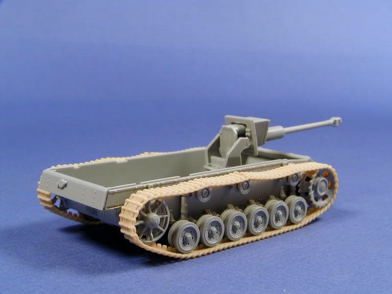

More detail added.
And now we are no longer box stock........... I had to fix this loop. The molded on one just looked awful Rolling Eyes Oh well. I am sure you guys knew it would happen lol!

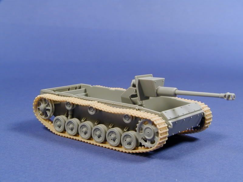

last but not least, the gun is test fit. The barrel is slide molded in one piece and is very nice. Just a little bit of sanding to get ride of the mold seam and we are good to go. Seven parts make up this assembly, and it looks just right.

What I like is the multipurpose tool and really that these carrying out a very clean and excellent work...

The sag of the tracks looks terrific John, another tip to remember Mad

Thank you. Basketball I thought it might work, and it did for awhile but as you will see, it did not last Crying or Very sad

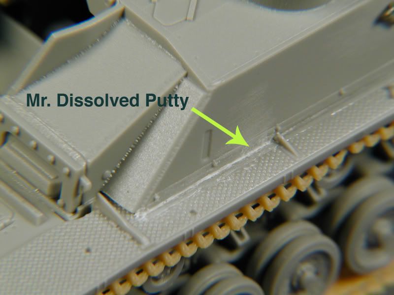

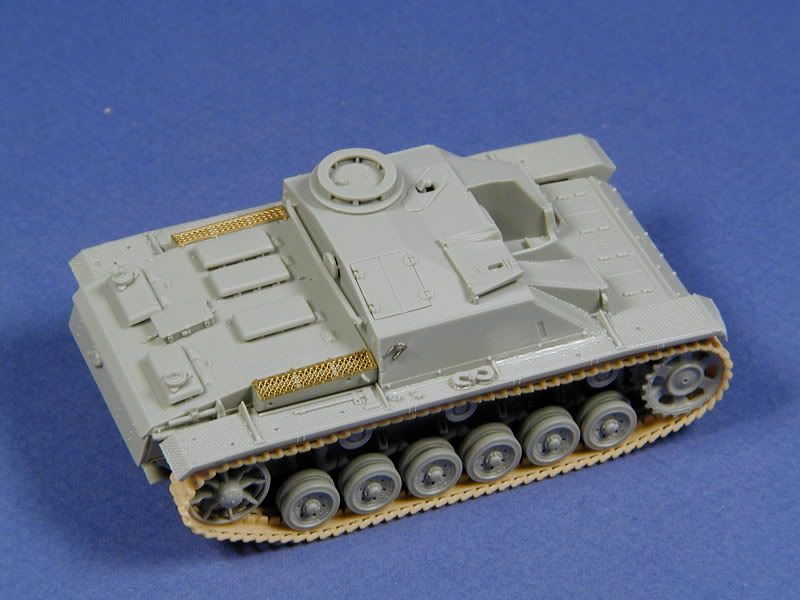

Well here we are again. As you will see I have joined the upper and lower hulls.

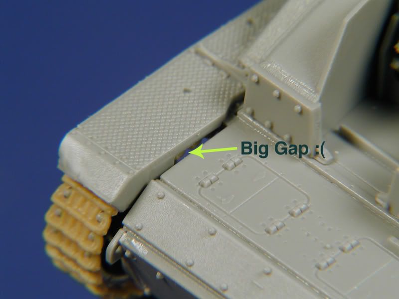

Overall fit is not bad, except for a few areas that need a little help. I needed to use a little filler at the side of the sponsons.

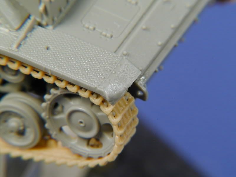

There is also a big gap at the front fenders........
So, out came the reference books and I found the solution for that problem study
There are a couple of brackets here that the kit does not supply (?) Easy enough to make, so it's no big deal.

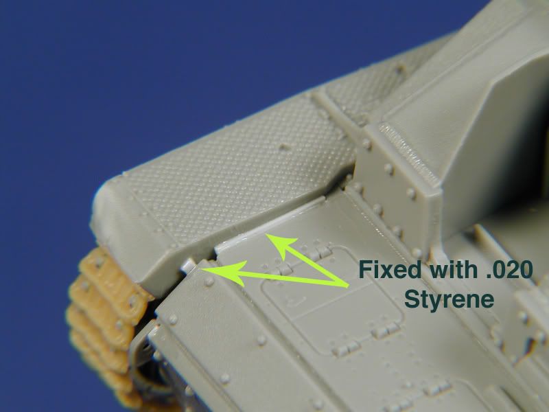

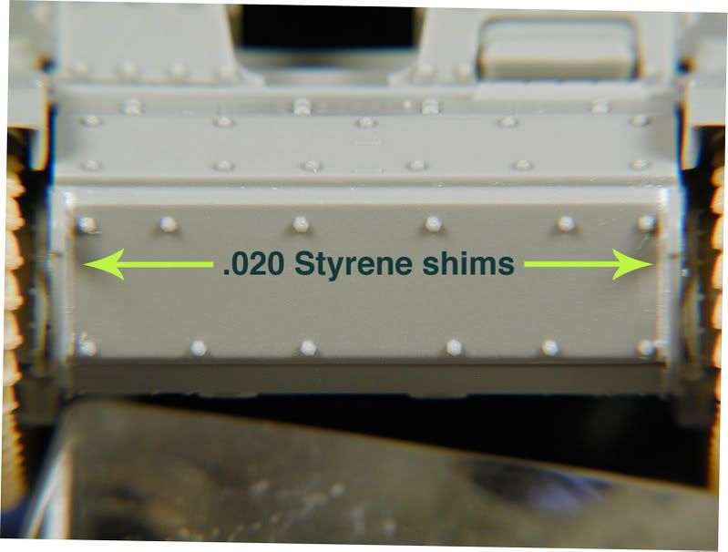

Also there are gaps on either side of the Glacis applique armor. There should be a little space here, as this is a bolted on piece, but the gaps were much too large to let get by.
Styrene strip to the rescue once again! sun
