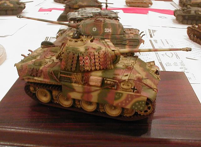

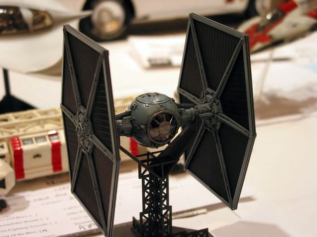

I will post a How-to for the wood props after the contest is over. Okay the Awards.......Since LU, let that cat out of the Bag sa I will detail them for you.

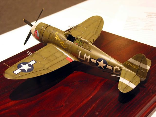

1st. Place, 1/48 Panther Ausf G (early)
1st. Place, 1/48 Heinkel He-162 A-2
1st. Place, 28 mm Goblin Squig Hopper (Wargame Miniature)
2nd. Place, 1/43 Porsche 908/3 Spyder
2nd. Place, 1/72 Tie Fighter (Empire Strikes Back scheme)
3rd. Place, 1/72 Me-262 A-1a
Best Out Of box Award, 1/48 P-47D Thunderbolt
Best Out Of box Award, 1/48 FW-190 D-9
Sorry I do not at the Moment have photos of them all, but as I get set , I will try to post more. Here are a few......

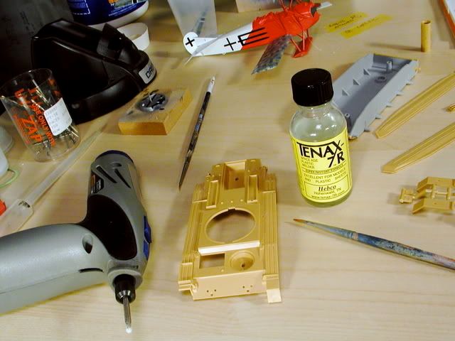

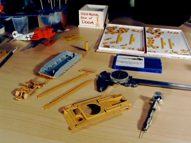

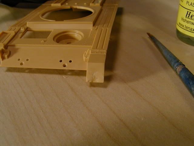

So here we go. Upper Hull,
Everything laid out ready to go,
Several holes need to be opened up at this point.......

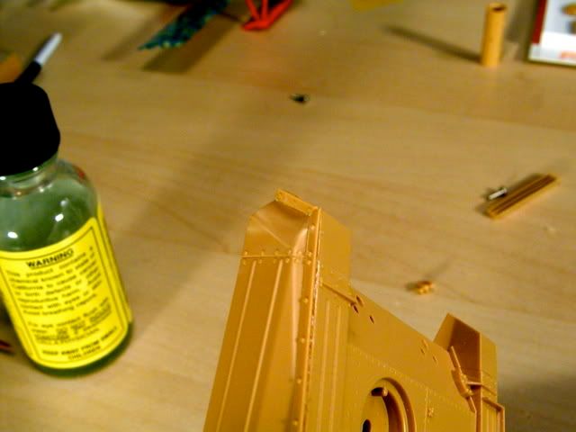

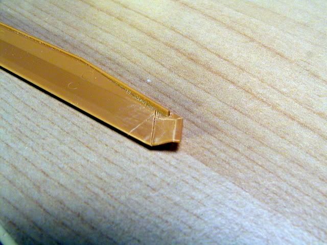

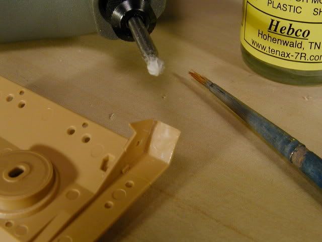

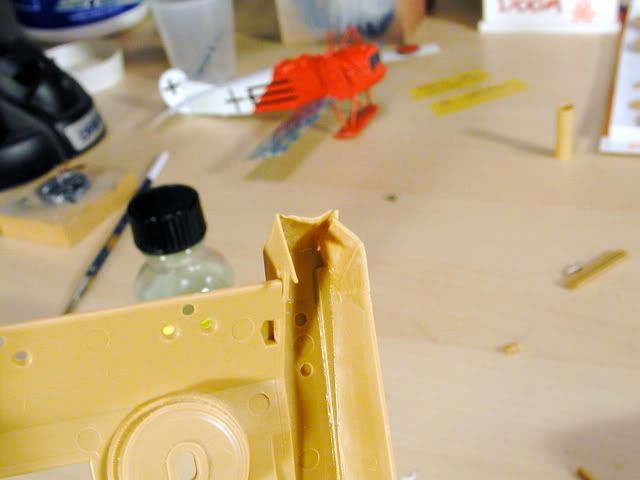

I thinned the back sides of the fenders, for better scale appearance. I like the chipped paint look used by several other modellers, but decided to add a little extra damage......
I used a Dremel tool with a ball end mill to further thin the plastic, so it would bend more like metal.......

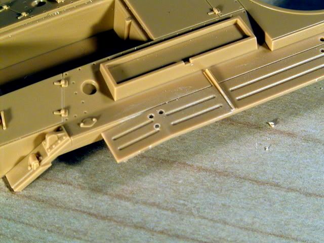

Also I cut along the inside of the skirt, following the panel lines, so that the bends occured in the right places......

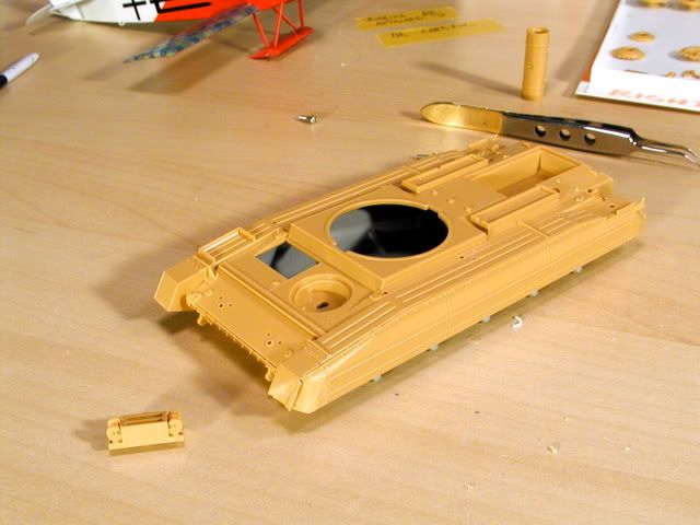

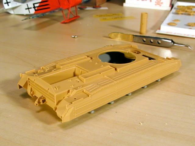

Ready to install!

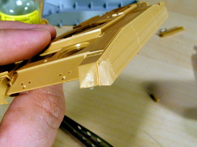

The finished product!!
That ugly seam has already been repaired......
