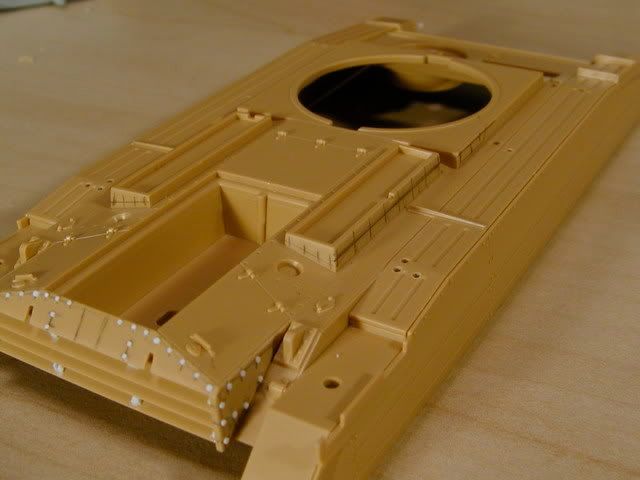

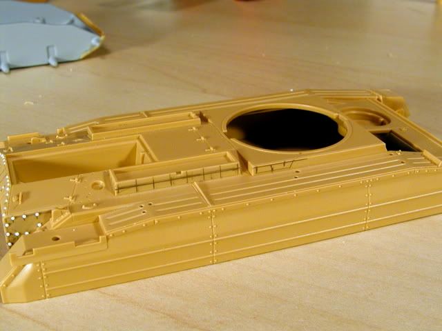

MensajeTema: More Rivets, Handles and Bins   Miér 12 Sep 2007, 4:05 am

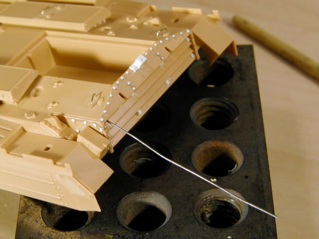

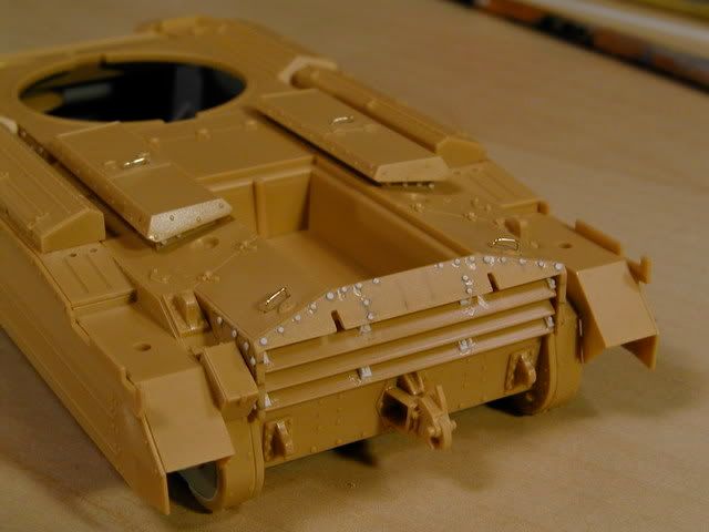

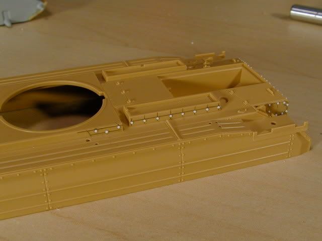

Panas,

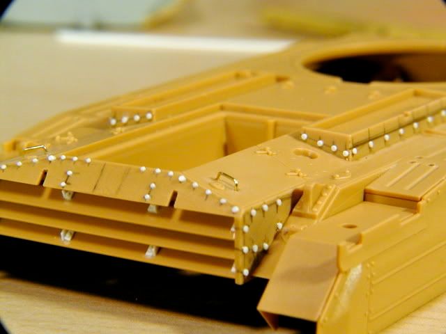

I apologize for the delay. Things did not go as planned , but I am here now with more of the Step by Step pena = pena = pena = pena =pena

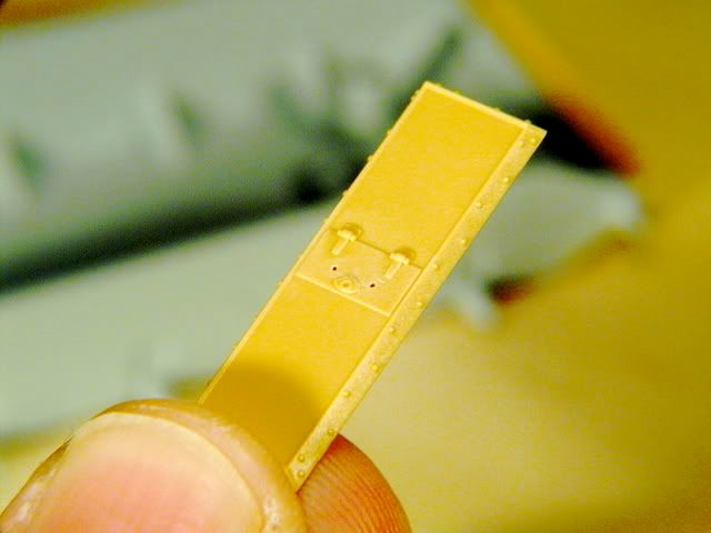

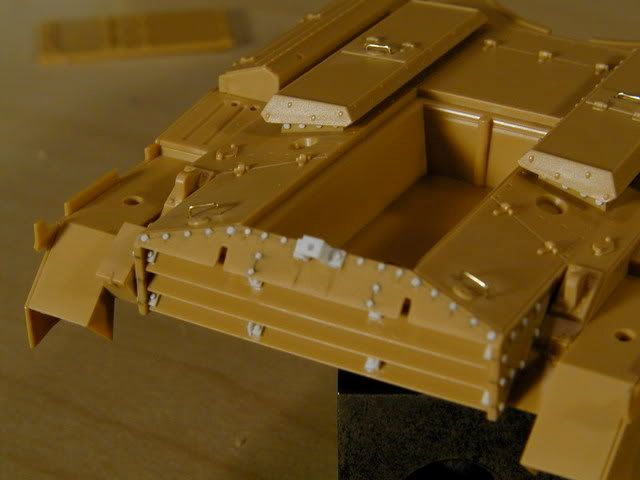

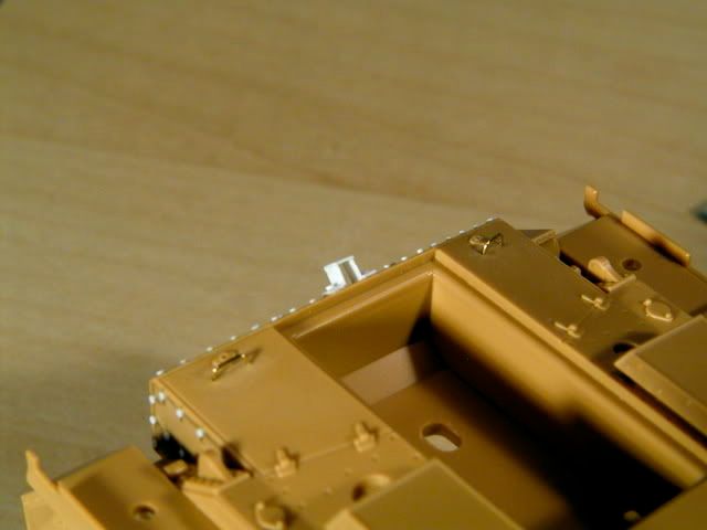

layout for the last of the rivet.......I think! ch
One side done :ale:
Finished product
And the other side and the backs of the......I am not sure what those are sa

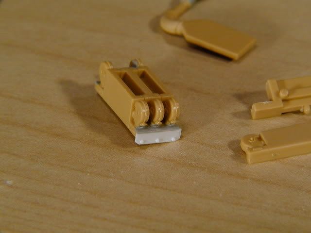

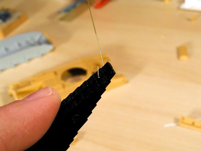

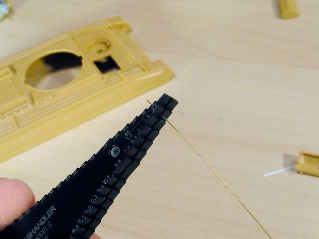

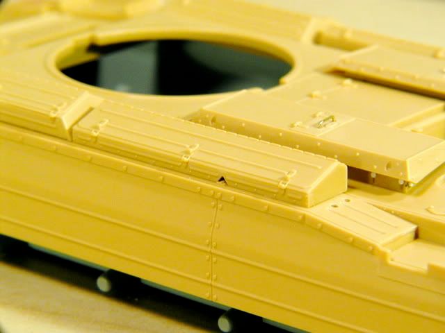

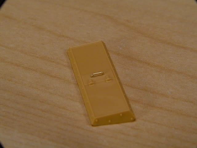

Now, time for the Handles :ale: First I use the molded handles as a location guide. And drill on either side of it.
Then, I use my micro chisel to plane off the surface.......
Carefully, So I do not remove that pesky detail Twisted Evil Then it is time for the handles themselves.

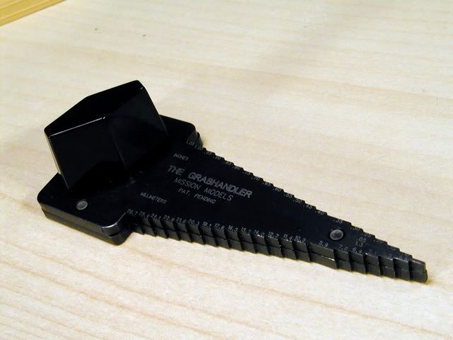

Another favorite tool :ale: :ale:
And now I have a Handle ready to install. The wire is Brass, .013 of an inch.
in this photo I use a piece of styrene to set the height.
Finished product. Now I just have to do the rest affraid affraid affraid affraid affraid
And here they are. Not as hard as I made them out to be, I am always nervous :ge when I need to scrape detail off :ale: :ale: :ale: :ale:

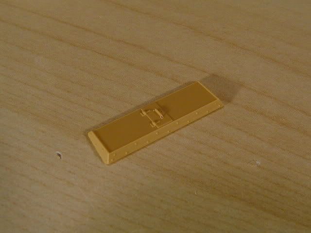

And with all the Bins in place......
So, as you can see, Most of the Rivet work this time is obscured. This is OK with Me. We know it is there. Razz

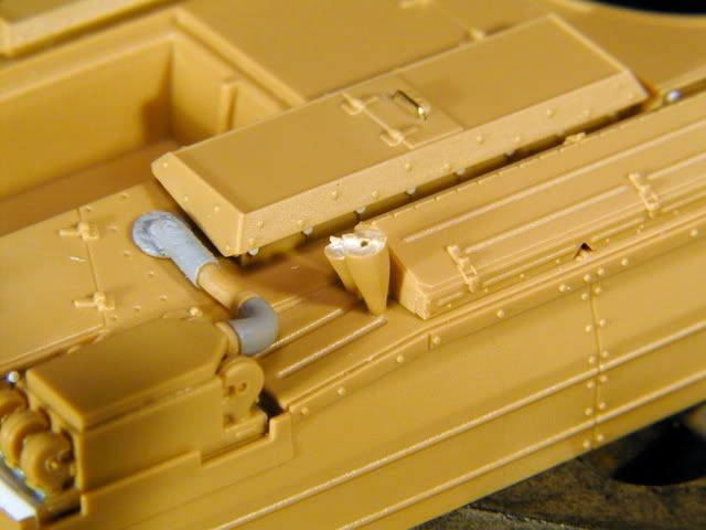

And one last thing, Amigos. The kit has these Triangular openings in the rear Stowage Bins.
I thought that they were wrong Evil or Very Mad And I was going to fix them, but I checked my Book and Tamiya has got them right ala Good referance pays off :ale: :ale: :ale: :ale: :ale: :ale: :ale: :ale: :ale:
Thats it for tonite. Am I going too far with the step by step Question Let me know and I will fix it pena
Best Regards,
Hey John that´s one of a hell tool you have there Twisted Evil I like it!!!

That tool is very good. Kind of expensive but it make life a little easier.

Basketball Yes it is a hell of a tool. It is fun to use! I could do the same thing with Pliers, but this looks much more impressive!

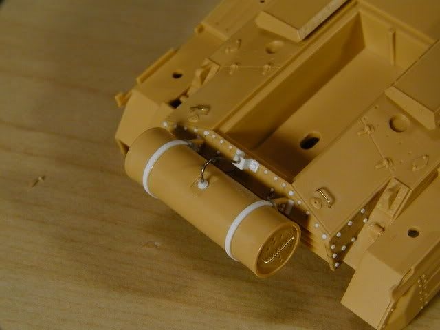

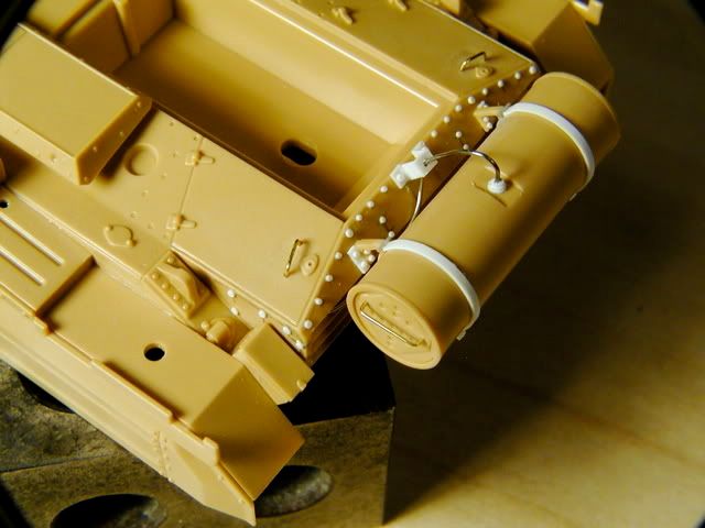

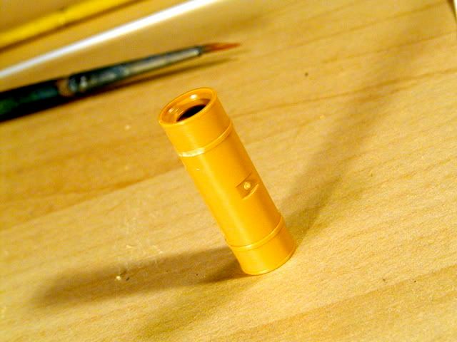

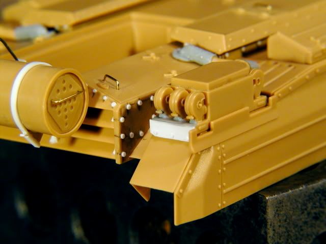

MensajeTema: Fuel tank   Vie 14 Sep 2007, 4:34 am
Panas,
Mad

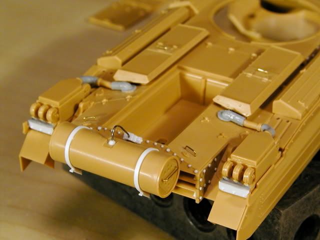

Another installment of Crusader! Step by Step!
Tonite (Morning?) we will install the Auxillary Fuel Tank. sun

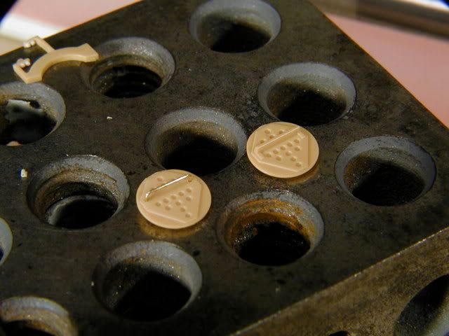

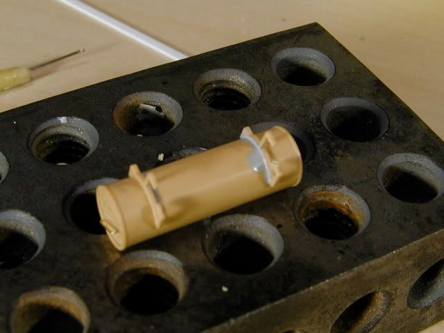

Okay, there is no photo of the first step......You would not be able to see it, really. It is a trick I learned building Airplanes :ge I use liquid cement,(Tenax) apply it wet to the seam. let it sit about 30 seconds then squeeze the part. This forces out a little melted Styrene. after it has set, about 24 hours, clo you can sand this excess off, and it will do most of the filling work for you.
Here is the Tank. I have started to remove the Strap detail.
Here all the Strap detail has been removed. This was done to make the seam easier to remove, and to improve the Strap detail, as you will see....
I had not intended to replace the filler cap, but it was damaged Neutral

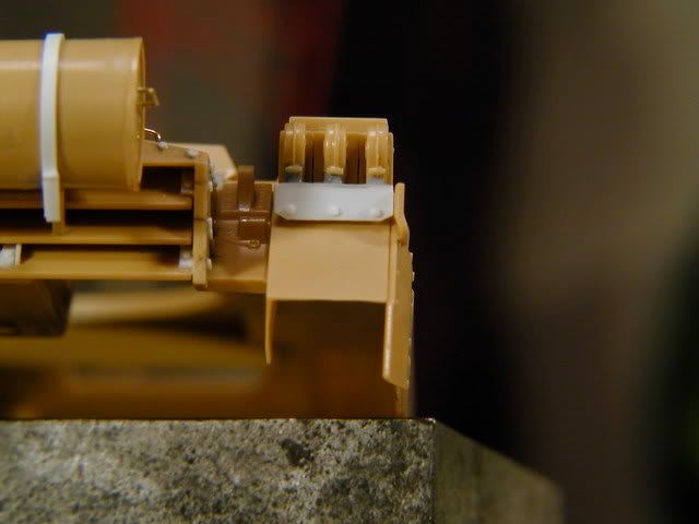

Next I thinned the mounting brackets to improve there appearance. The one on the Left is finished. Oh, and I added rivets, too......Twisted Evil

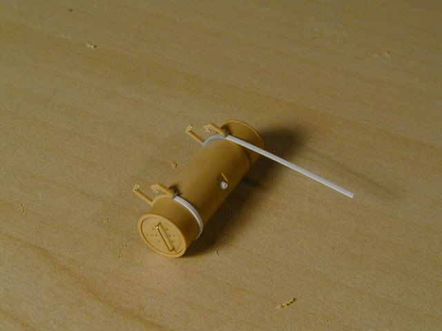

While I was doing the brackets I realised that there were grab handles on the ends of the Tank...... So I did that, too.
After the ejector pins were sanded off, the brackets left a little gap Evil or Very Mad
that was easily fixed with a little Mr Surfacer 1000. I brush it on without thinning it. It works great for this. clown

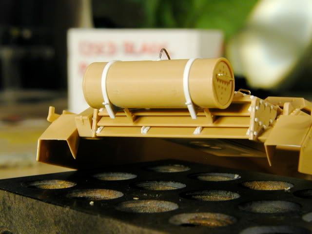

New Straps! Made from .010x.030 Styrene. These look more convincing then the molded part Cool There is also a tiny mounting pin there as well, but you really have too look.........
On Crusaders fitted with the Aux Tank there is a mount for the Fuel line. Mine has it now too!
And the beginnings of a Fuel line...... I used Solder for this.

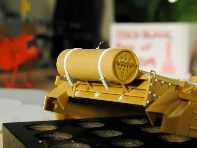

The Tank in place cheers
At this point I added a little more detail to the Straps......
When I cut the slots for the Aux Tank brackets I made them a little to big....... So I added these plates, which you can just see here next to the bracket, to hide this flaw. Looks ok now, and only an expert would spot it sa
Thanks for Looking pena
Best Regards,

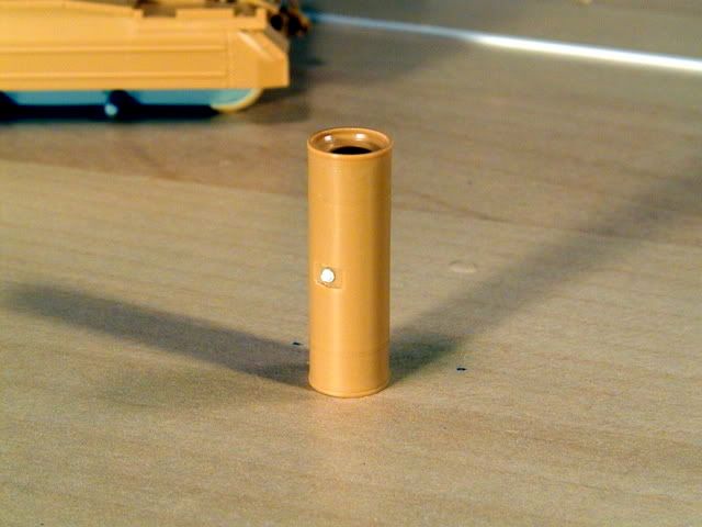

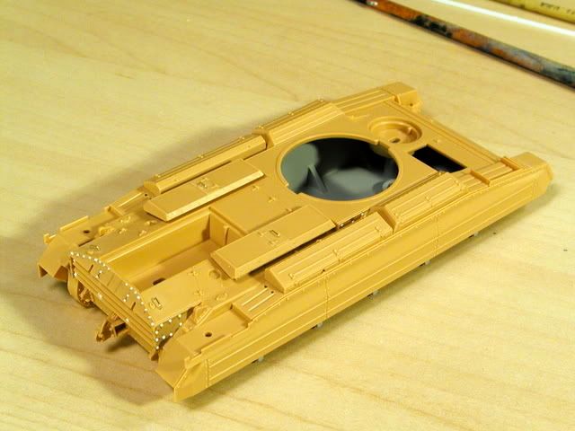

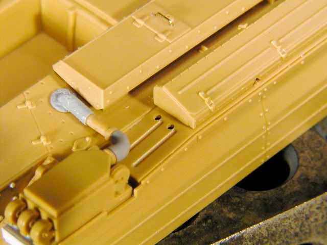

MensajeTema: Dirt!!!   Mar 18 Sep 2007, 3:25 am

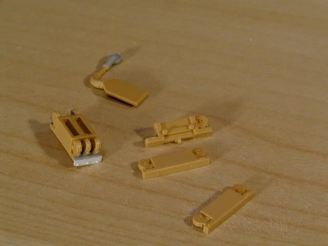

Panas,
Okay, just a short update today. I am allmost done with the rear of the Tank........Just a few more things! Like Air cleaners clown
As You can see, I have added the mount on to the back of the Air Cleaner. This helps to hide the seams. Also please note that the raised seams on the Shell shaped things should be there.....So if you build one of these Crusaders (and You should) leave them there Razz
And now in place,
X2
I added a little texture to the intake mount, as it is a cast part on the real Tank.
At this point I realised that the Fire Extinguishers are mounted in the wrong place Neutral
After I drilled the holes Razz Okay so to fix them I swiped Andres trick of using the stretched Sprue ends clown Nice Work Andres ala ala
So now I will let those set and smooth them out next time :bounce:
Thanks for looking, Amigos :medal:
